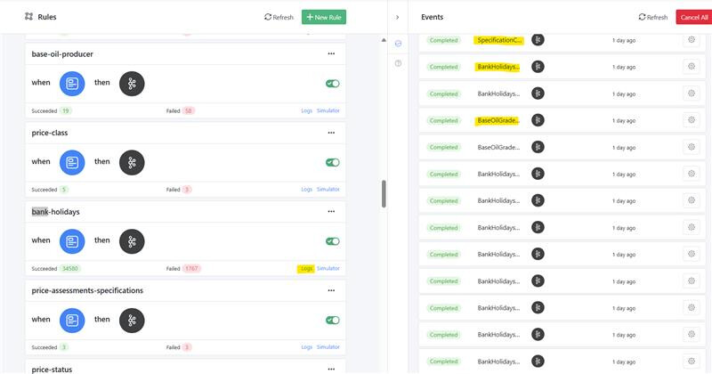

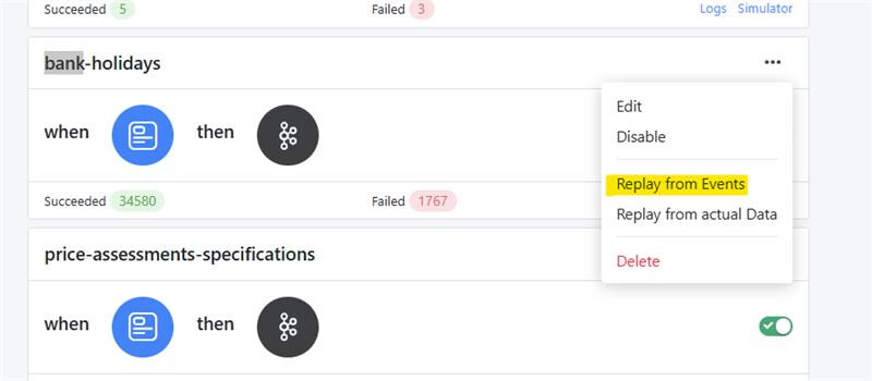

When a rule is replayed via the menu option:
It is running for a lot more content records than it should do, including ones in other schemas that the rule is not configured to use.

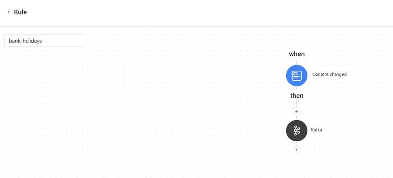

The schema is only configured on the “bank-holidays” schema:
but when replayed it’s picking up contents from other schemas and trying to use those:
We would expect only that one rule to be run with only the data from the schemas related to that rule
