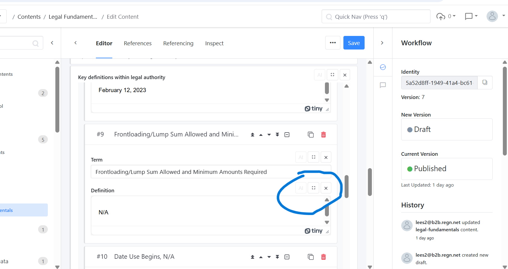

We are calling custom component inside squidex array field list. when we click on Fullscreen mode toggle button of squidex field then that field goes disappear. squidex field does not appear as full screen mode.
When click on Fullscreen mode toggle button
Then The size of the field should size with the full-screen mode.
Within squidex array list, select full-screen mode of a child field .

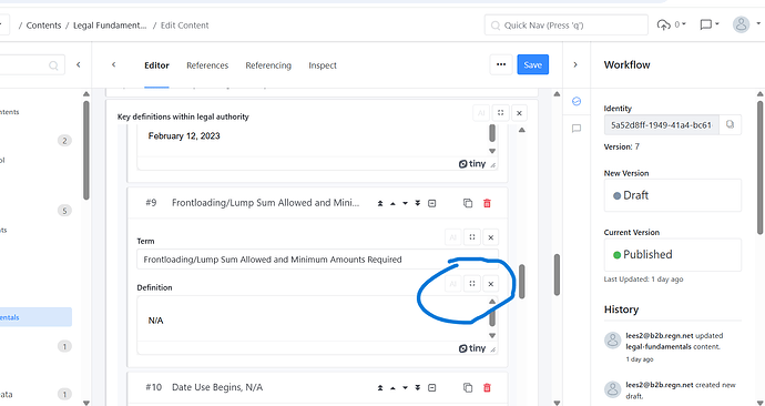

I have got the information via email (please do not send me emails !!!) that it does not work. I cannot reproduce it. Is there a special kind of field that does not work? I have checked out the latest code to test it again.
Hi @Sebastian Thanks for checking email. we are calling custom component inside array field. but I also checked with adding RichText editor inside array. that RichText editor’s field expand also not working properly.
