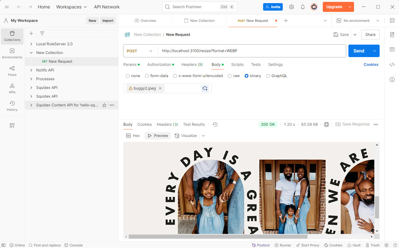

I can’t reproduce it. Perhaps the forum changes the files before they are uploaded. But it works for me:
