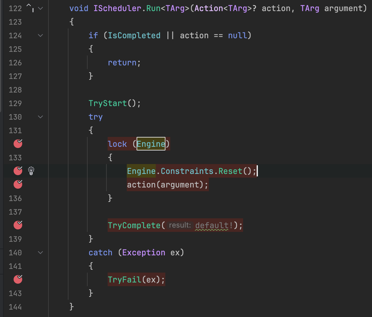

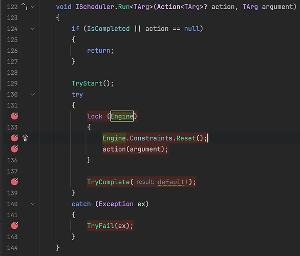

I confirmed that Evaluate did not return due to the await section while executing the script code.
    public override JsValue Evaluate(Prepared<Script> script)
        lock (Engine)
            return Engine.Evaluate(script);

I wrote a simple script that reproduces the problem 100%.
The first time I run Evaluate, I get a lock, but it doesn’t return, and when I try to make an http request and pass a callback, a deadlock occurs when I enter the second lock.

I have pushed a fix whereI removed the initial lock and it seems to work fine.
