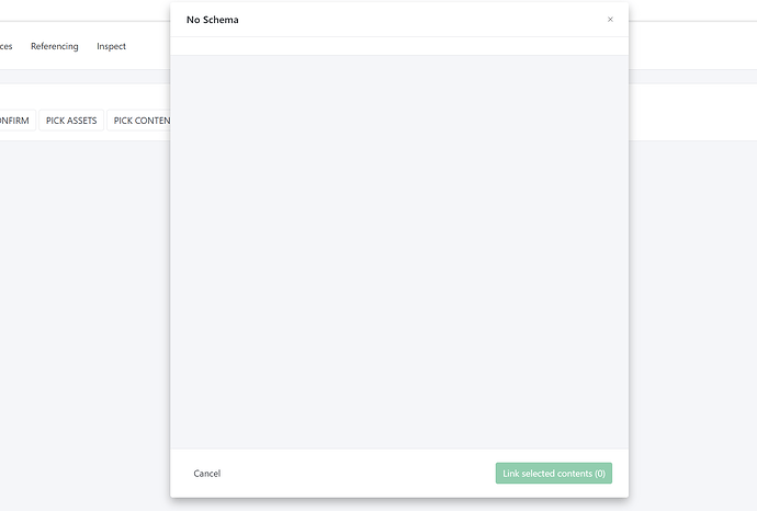

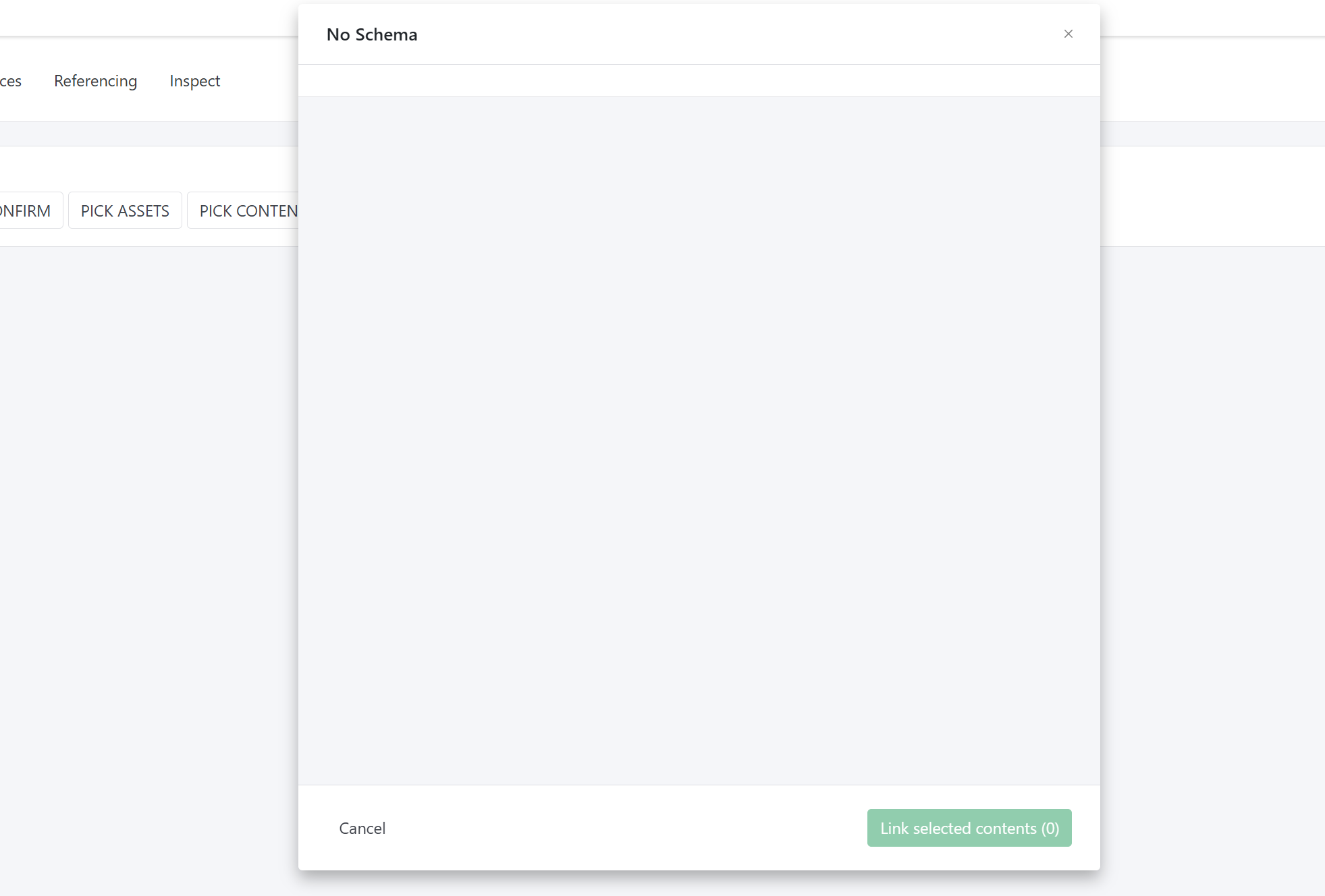

I try to make custom editor and currently struggling with “pickContents”
I tried this example and it always “NO SCHEMA”
https://raw.githubusercontent.com/wild-card-ai/squidex-cms/24782bd550b5346bc9f92aa164d512e7822d1303/backend/src/Squidex/wwwroot/scripts/editor-dialogs.html
In my version i tried manually hardcode schemaId or schemaName both result in same.
Is there anything I missing or is there any docs covering this?
Show proper dialog.
Used same example with any field.
Version: latest/cloud
