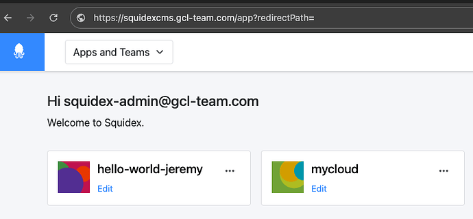

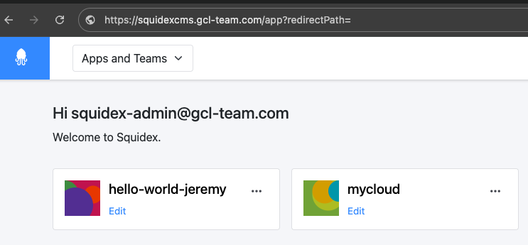

Step 1: I have an app called “mycloud” on Squidex, as shown in the following screenshot.

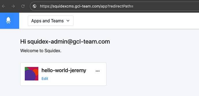

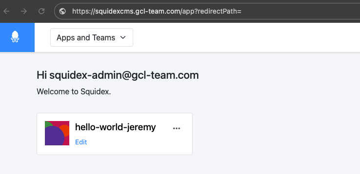

Step 5: Now I visit again the Squidex page, the app “mycloud” is already deleted, as shown in the screenshot attached at my next reply below.
As we can see, even though we have specified to delete the app “chunlin-test” with the --name, which is an app not even exists, the CLI proceeds and deletes the “mycloud” app which is not even indicated in the deletion command.
Hence, this leads me to think whether merely checking the equality of name and confirm is enough.
Hope this clear your doubts and thank you again for your time!
Attach the Step 5 screenshot here:
