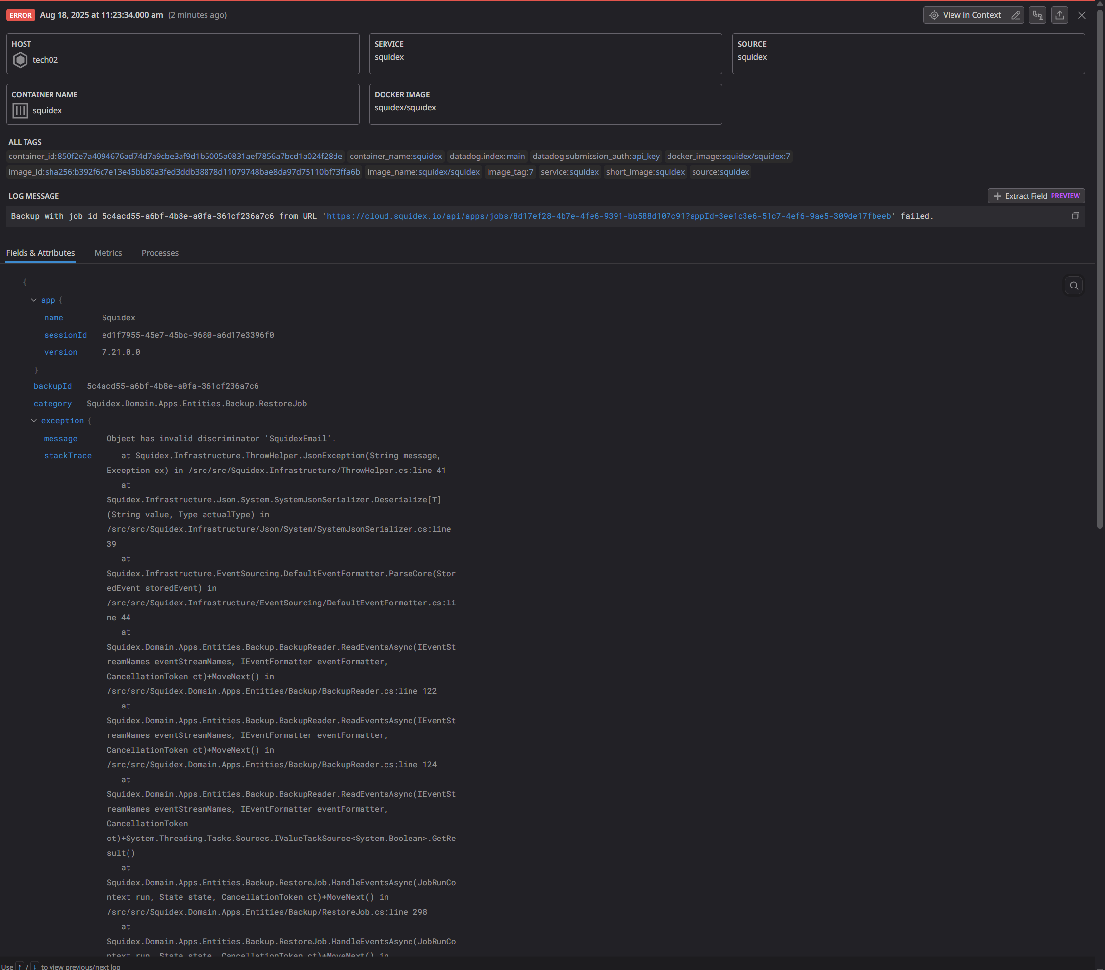

I think this is a feature gap, because some types are not available in on-prem and you had bad luck. This rule action is only available in the cloud.
by types, do you mean content/schema types, or something like email addresses? I’m using OKTA on-prem, but google auth in the hosted version.
I am talking about the possible rule actions. There is a SquidexEmail rule action that is only available in the cloud. You can fix it by assigning another rule action in your backup. So basically:

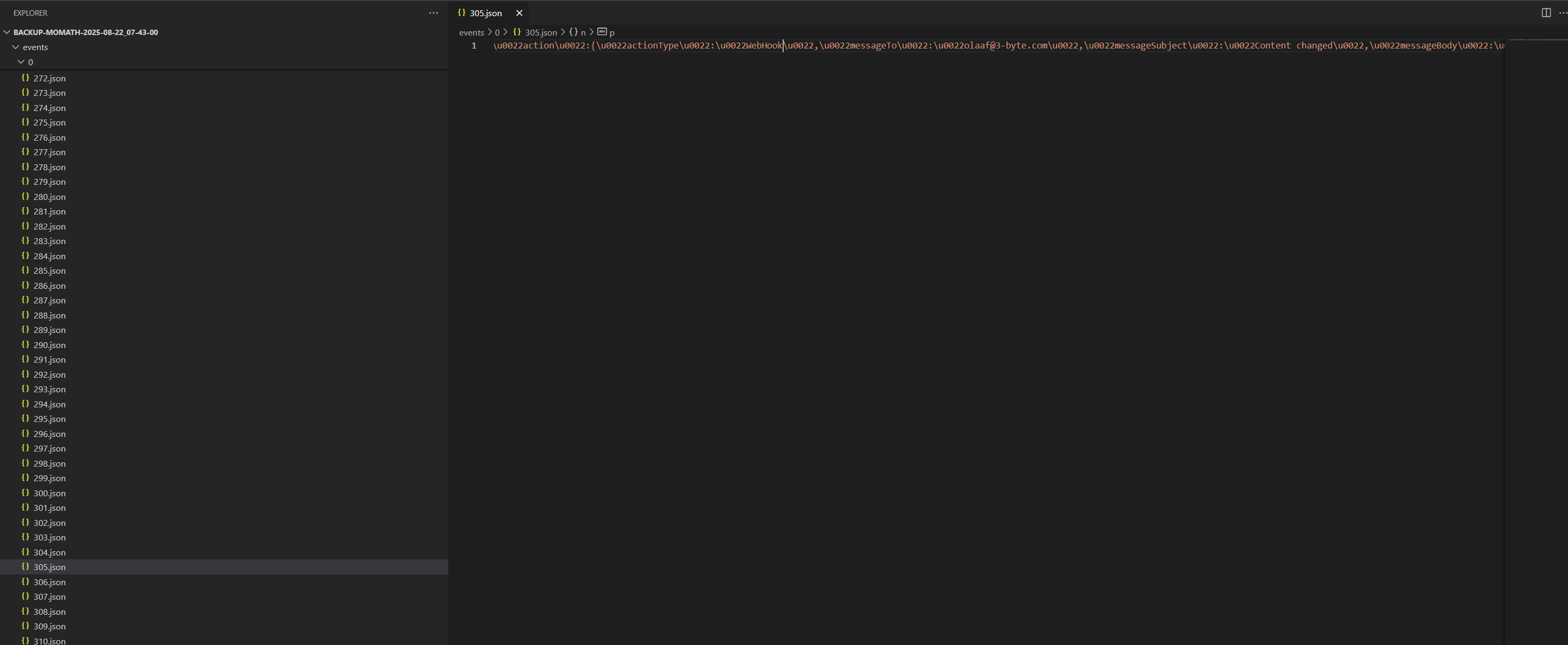

OK, thanks- yeah, i found the rule- I replaced it with webhook, but left the other fields, like email address, etc.- it still failed a restore. I then deleted the JSON file and tried a restore, but that didn’t work. Should i create a webhook rule, download that, and copy paste over the offending email rule event?

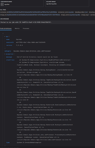

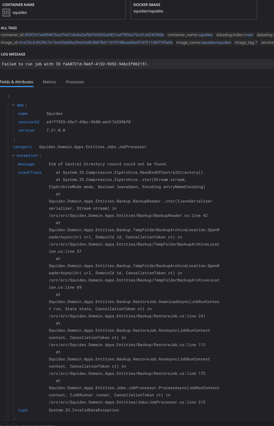

This looks like the archive has been corrupted so that it cannot be opened anymore.
On this version I replaced the SquidexEmail with Webhook. I then added a webhook rule, backed that up, and copy-pasted from Webhook rule on the last event JSON file back to the email rule event. I then re-zipped, uploaded to dropbox, but get the same error. Can you suggest a path forward? I’d be happy to pay you to fix this for me : )

There are 2 problems here:
  1. The files you have changed are not correct, check especially 305.json (not sure about the other).
  2. You have created a new archive with a root folder, but Events and Attachments need to be the root folders.
I have also digged into the code whether it can be done automatically. But I am not sure yet. Would you also send me your original backup?

I have a migration that works automatically. It is part of the latest dev version
Hey Seb, which branch is this migration code on? I’d like to build and deploy as a test.
It has been merged to the master branch
