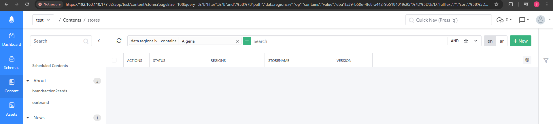

I am having an issue when searching through reference data, What I did is that I created a schema named region and added some content in it, afterwards I created another schema named stores and used region schema as reference in it (set dropdown as editor). Now when I added content in stores schema and doing a search through region reference, its showing me nothing, what I could be doing wrong here?
Picture is attached for a reference.
