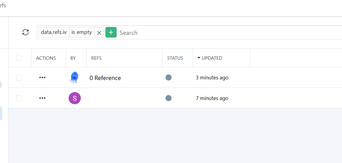

I have tested it and it works fine for me.

The query uses the size operator for arrays. This seems to work locally, but I will try it again.
