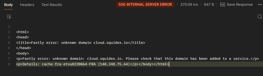

Thanks for checking on your side. However, I am still not getting an Unauthorized error. Instead, I consistently receive a Fastly error when trying to access the CDN GraphQL endpoint:
<html>
<head>
<title>Fastly error: unknown domain cloud.squidex.io</title>
</head>
<body>
<p>Fastly error: unknown domain: cloud.squidex.io. Please check that this domain has been added to a service.</p>
<p>Details: cache-fra-etou8220064-FRA (140.248.75.64)</p>
</body>
</html>
This looks more like a CDN/domain resolution issue rather than an authentication issue.
Could you please check if there is any configuration missing for my project on the CDN side, or guide me if I need to enable something explicitly?
