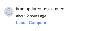

Screenshot 2025-08-27 at 20.23.31
I also noticed that no HTTP call is being made when click “Load” or “Compare”. Any idea?
