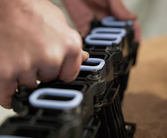

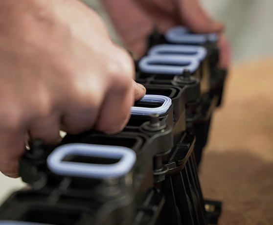

Thanks, @Sebastian for the prompt reply. Just did some tests and it’s working. For some reason, if the source asset format is in WEBP, &format=PNG works but not to JPG. Is that by design?
Perhaps because transparency or something like this? Can you give me an example?
there was no transparency…
attached pic
I mean do you have an example URL to your squidex instance where you make the resize.
Works for me: https://rycocms.azurewebsites.net/api/assets/rycodev/874a04b8-af1c-4fa8-9b97-81c12fd107bb/?format=JPEG
oh my mistake i was doing JPG…
