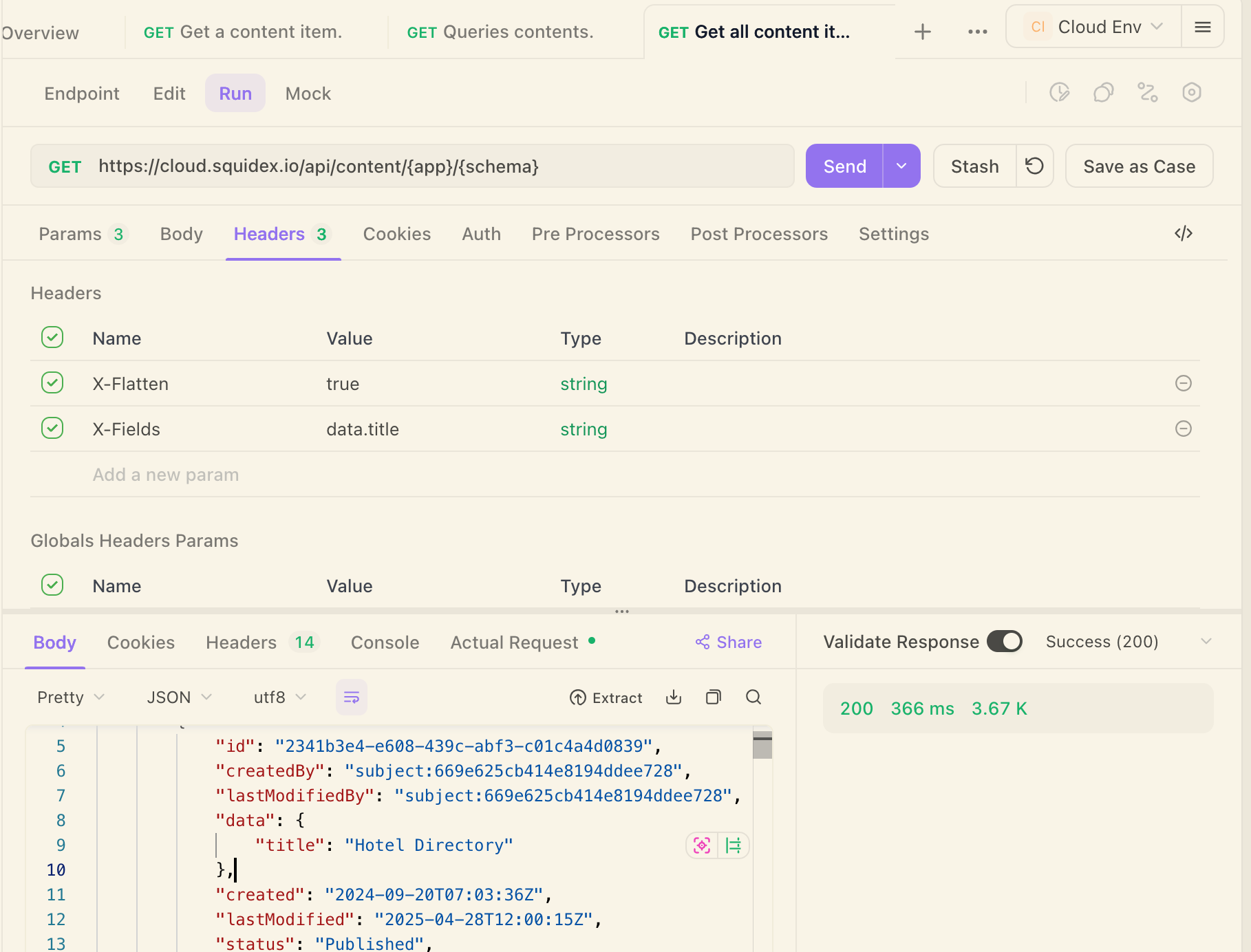

I call an API example, the X-Flatten has an effect, but the X-Fields has no effect.

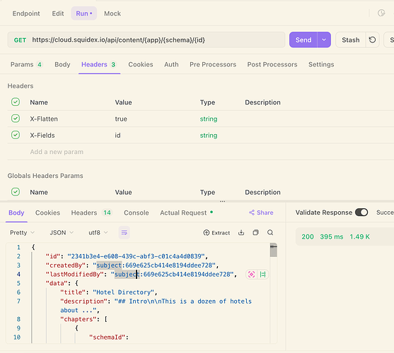

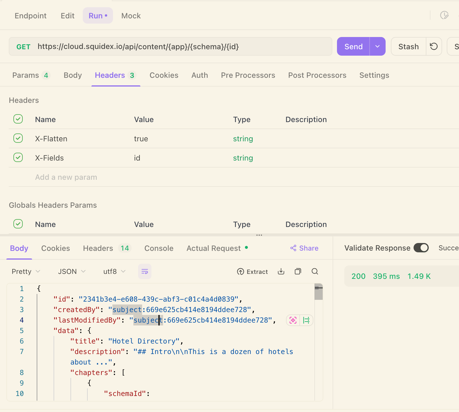

Even if I use the minimum param, only id, it still doesn’t work.

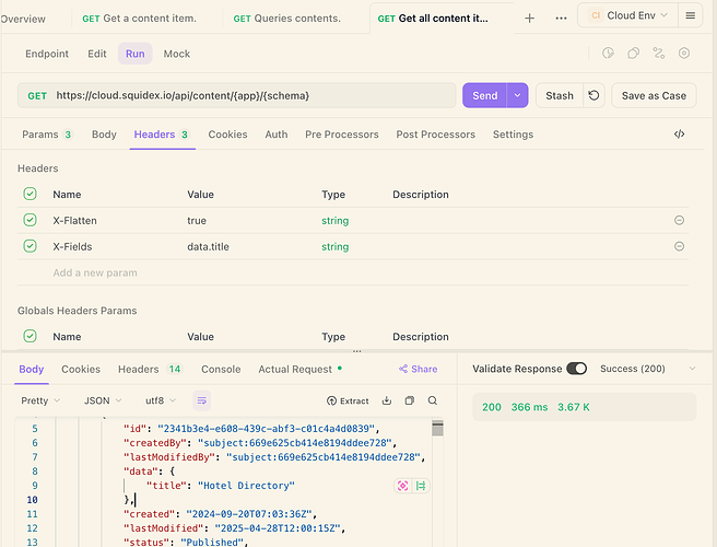

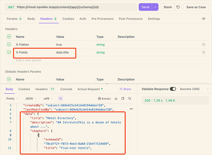

I put 'data.title′ to X-Fields, but this response return all data fields.

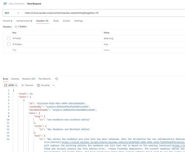

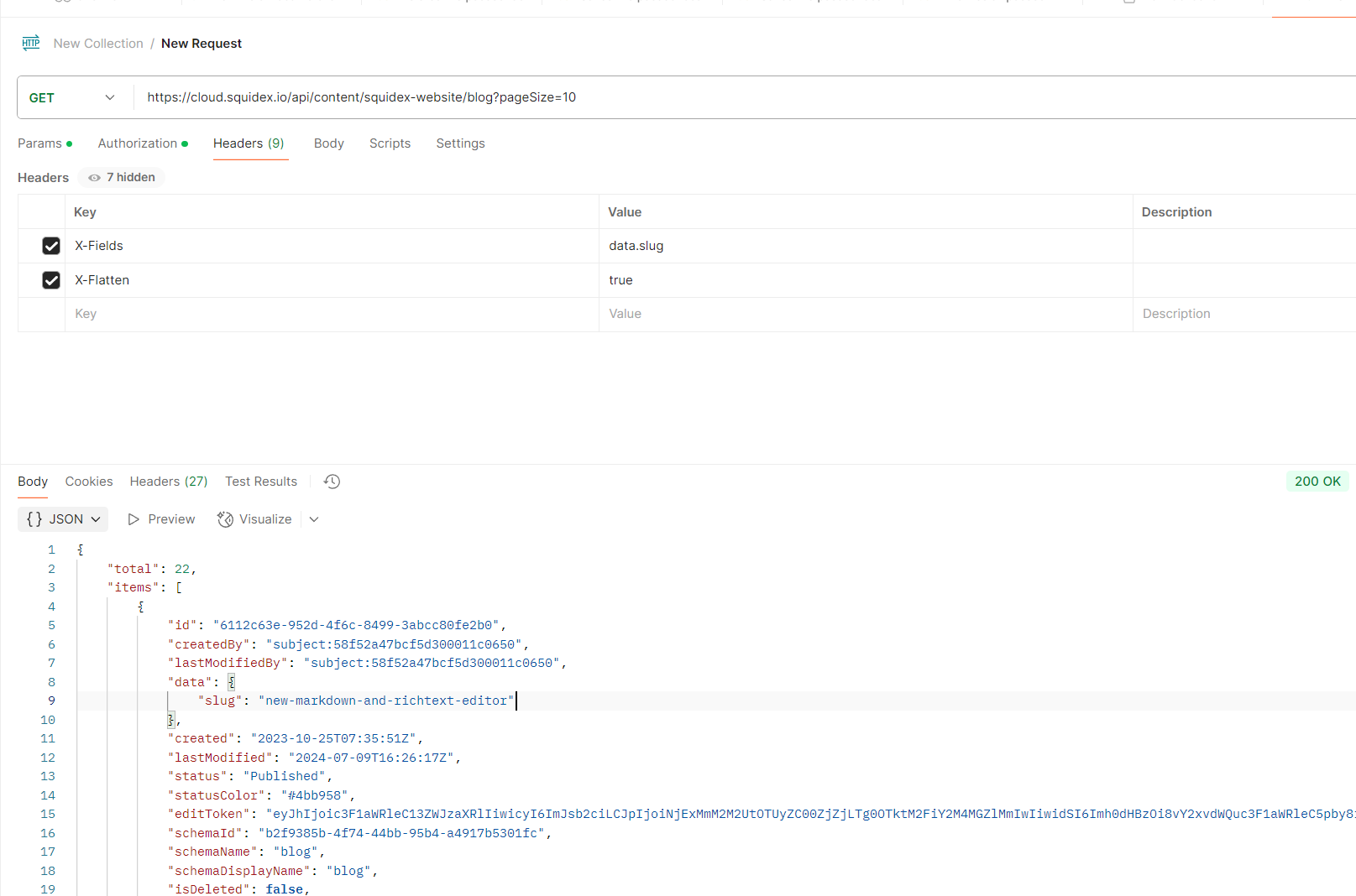

For me it works:

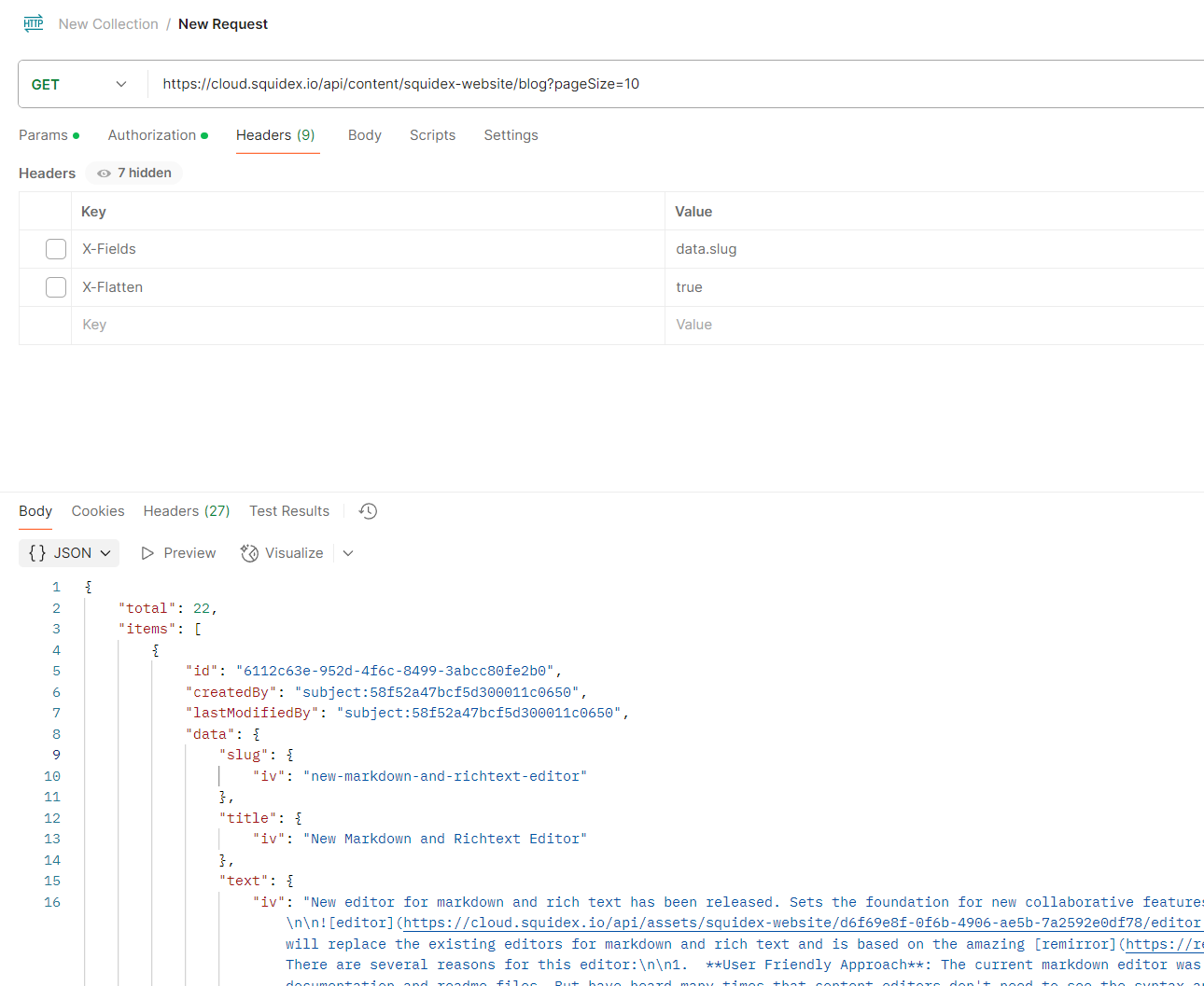

Without headers:
I think I never enabled it for the ID query because I didn’t need it for the UI

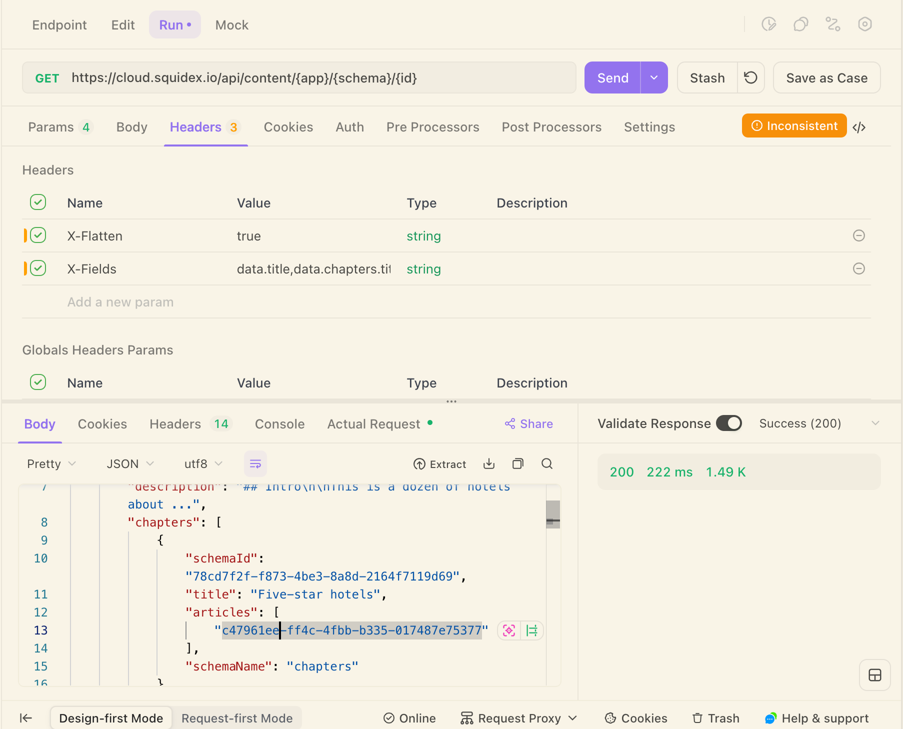

That’s awesome! Thank you mention me this, I removed the id param, it worked.
Seems it has some problem with id.
Yes, but as I said: It was never needed for this endpoint, so I have not added it. You can create a feature request, but it does not have the highest prio as I encourage everybody to use GraphQL anyway.
I wonder why the API with ID didn’t work.

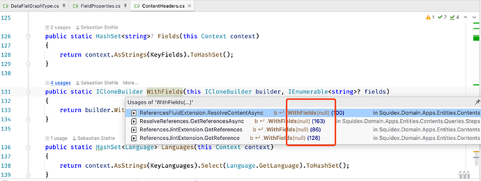

I found this reason in the API without the id, it has a feature([AcceptQuery(true)]、[AcceptHeader.NoSlowTotal], and [AcceptHeader.NoTotal]), and other API don’t have it.

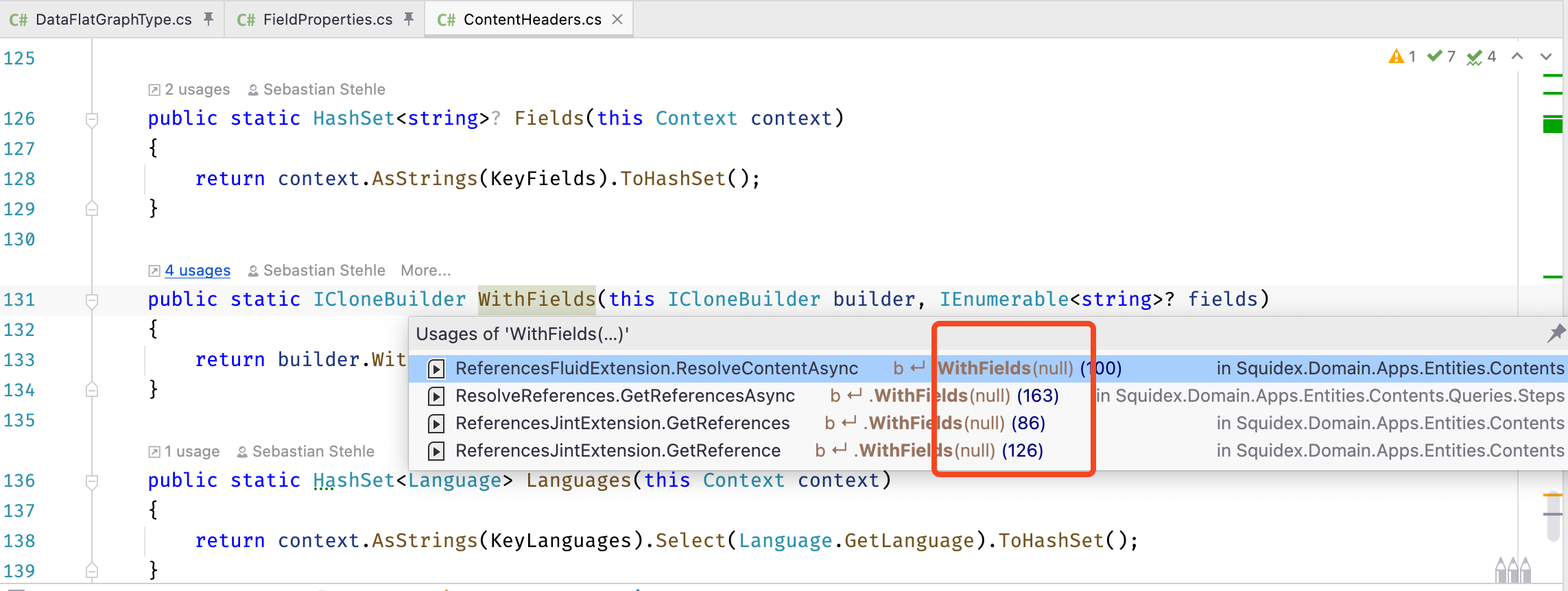

The actual problem is that the API with id uses the FindAsync method, the others use the QueryAsync method, and the QueryAsync method calls a ParseCoreAsync method calls a ParseAsync method; the key point code is the WithFields method. But the FindAsync method does not call the WithFields method.

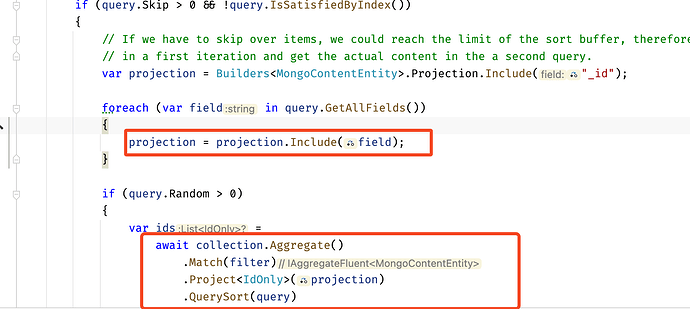

Do you override the API([Route(“content/{app}/{schema}/{id}/”)])? I am viewing the source code of FindAsync, but I can’t understand it. This seems to read from the event message, and I have even used it.
What do you mean with override? The acutal code is here: squidex/backend/src/Squidex/Areas/Api/Controllers/Contents/ContentsController.cs at master · Squidex/squidex · GitHub

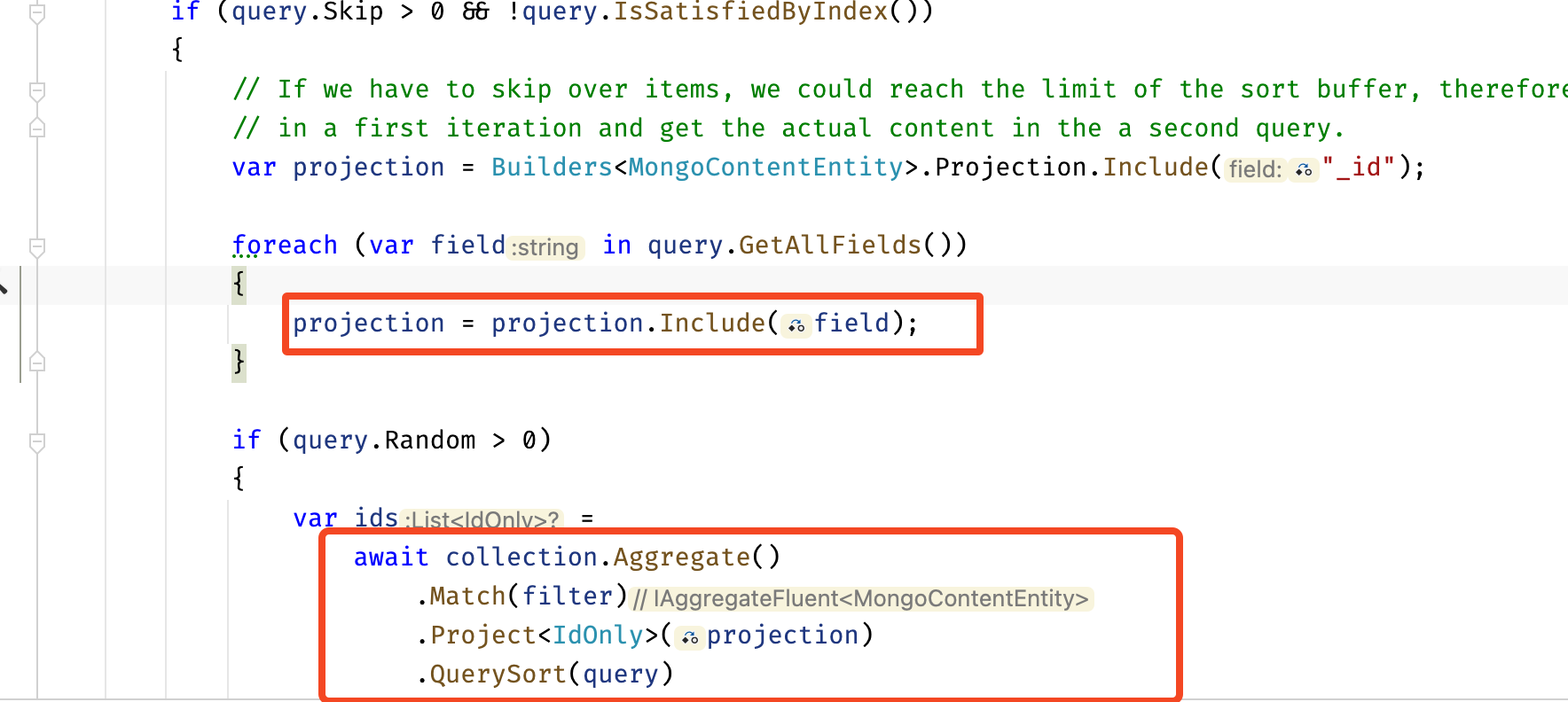

I saw this, the FindAsync method, finally execute WithEventSourcing, this is an event message, and I haven’t used it, how to execute query, and there seems no way to filter fields.
I means how to handler fields params.
You have to follow this path: squidex/backend/src/Squidex.Data.MongoDb/Domain/Apps/Entities/Contents/MongoContentRepository.cs at master · Squidex/squidex · GitHub
